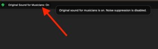

When in zoom meeting, in the top right corner switch to audio mode for musicians. That worked for me.
